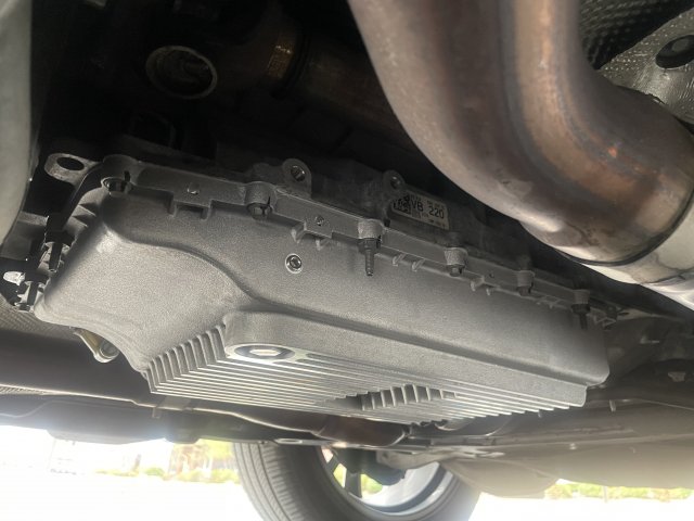

This is about the trans pan not the retardly overpriced gauge I bought so I can get rid of the NPT port and when I take my dash back apart I’ll post detailed pics of the potential fire hazard I created but it wasn’t worth it but it works

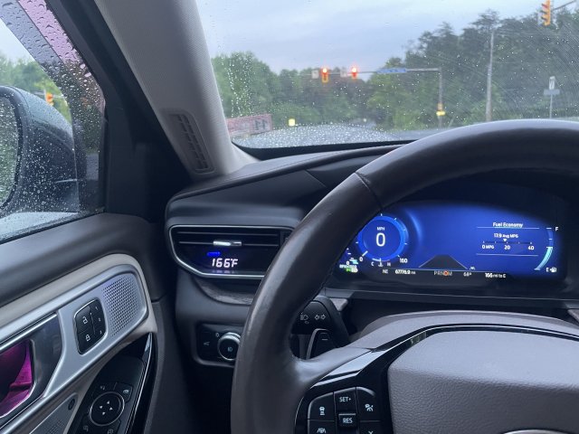

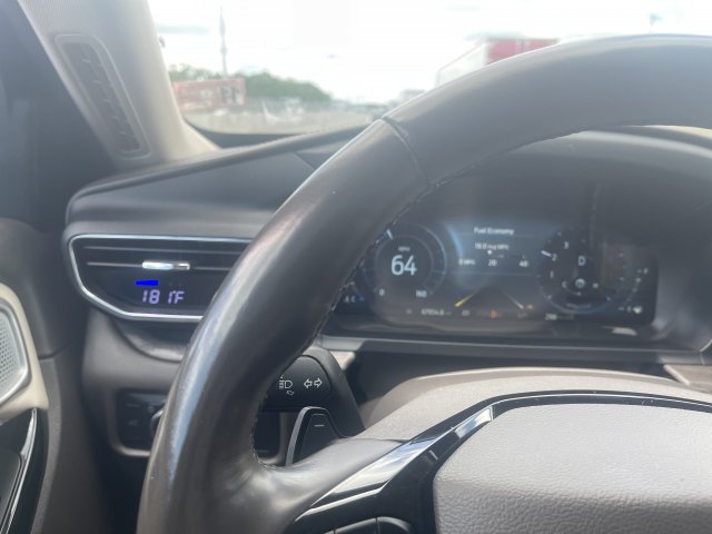

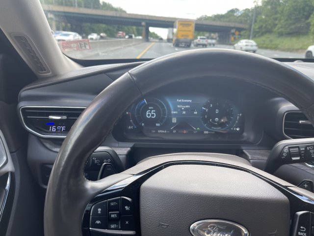

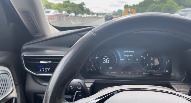

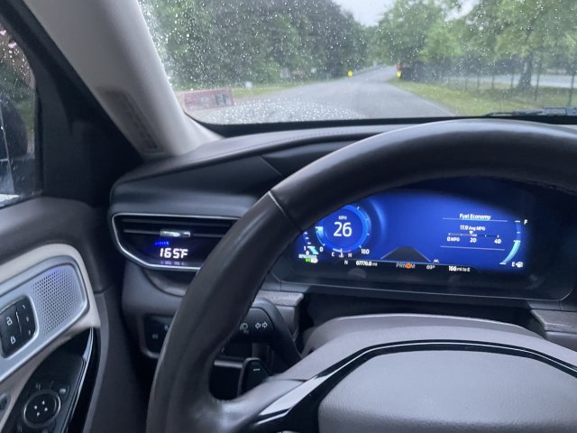

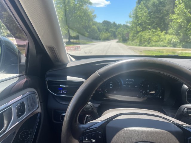

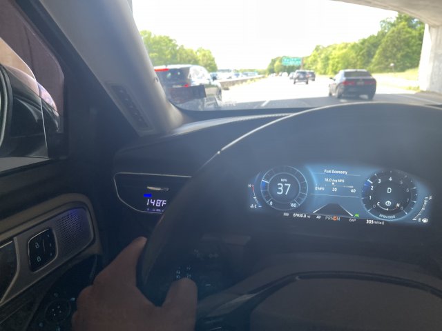

The 192F is the coolant, there is a 170F thermostat in the cooling system and I know it opens at 174F so the car is currently trying to cool itself the 166F is the trans temp it’s about 66F-68F outside based on the temp reading in the car and the weather app on my phone backs that up, pics were taken about a mile apart between lights and I’ve been driving for about 35min and just got off the highway, these are my results you can take it or leave it, it’s just free information

That’s what I was trying to explain, I’m an engineer and fix helicopters for the army and one of the main reason for component failure especially for plastics is heat cycling or heat soaking and I wanted a trans pan to get rid of the heat as fast as possible when I turn off the car instead of the fluid sitting in the plastic pan which keeps the heat in, I think the misunderstanding is that the metal pan magically keeps the temp down but it doesn’t during heavy acceleration, stop and go traffic or any driving conditions where there isn’t constant airflow over the pan the temp easily raises close to 200F, only in the very specific situation when driving down the highway at 50mph or higher at a consistent engine RPM for a prolonged period of time do the temp drop down to the 170F range once that specific driving situation ends the temp starts to raise again

I agree, the Platinum is no slouch either and it’s a little hard to tell under normal driving but it doesn’t keep up with the ST when it comes to the upper end of the power band but I bought it as a long distance cruiser and it’s amazing at that with way more power than it needs, I wish someone would make an oil pan replacement, I’m tempted to just scan the plastic one into CAD and copy the the aluminum thickness and radiuses of the PPE pan and just CNC machine one out of some billet aluminum for testing

Your digital gauge swings from 148 degrees to 185 degrees yet the dash gauge never moves! That should tell you something about it's acuracy!
Those digital guages on the instrument cluster are calibrated to the 2 extremes of the temp range so a normal person with no mechanical experience can look down and judge if the car is in good working order for example the coolant gauge hits the center at 174F and stays there all the way to about 230F the same situation applies, it was never meant to be used in a maintenance setting hence why the maintenance manual says to use a scan tool and the temp range in the manual is at the upper end of the range specifically why every other fluid has a high low range to allow for expansion and contraction, because if you check it at 135F there might not be enough fluid for the expansion required and if you check it at 225F there might not be enough fluid to run reliably when the fluid cools and contracts back down
