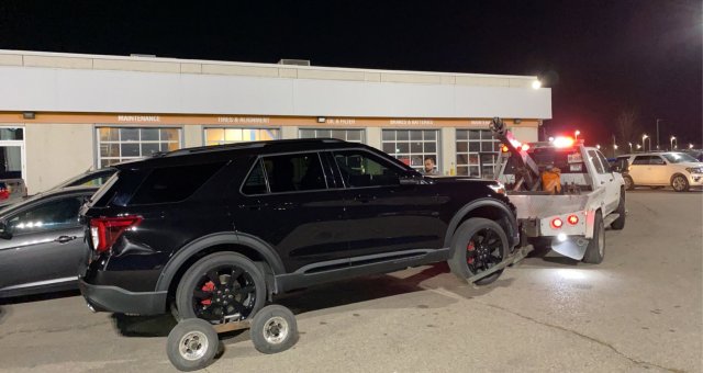

I then used CAA to tow my Explorer to my dealer on November 10, 2022. The dealer has since replaced the PCM Harness and Re-flashed the entire software on the car. I am following up often and they keep saying their shop foreman and technician are working close with Ford Canada to find the root cause of the problem.

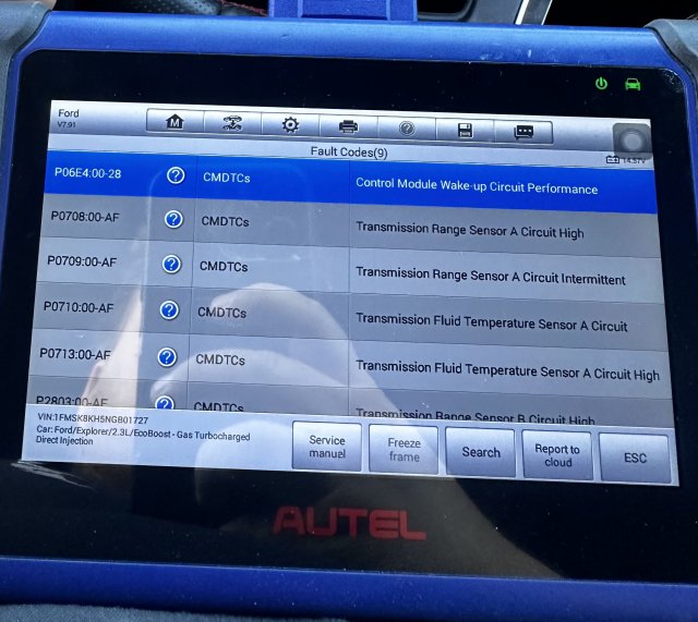

yeah it’s very weird dude, got a brand new battery, did BMS reset, reflashed the PCM, but keep getting these codes, and then after it sits for 10-15 it starts driving normally again. Dealer got no idea what this is lmao
the DTC for the shutter grille is normal, i had it off when scanning the codes, and the fluid and everything is normal level. Thinking maybe it is a bad range sensor, tho that’s wild at 36,000.

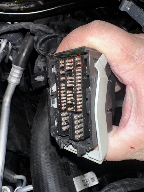

***UPDATE; FIXED THE ISSUE***
so it’s been over a month of me searching for the issue, no luck. i eventually decided to pull apart the connector from the pcm, and as u see in the picture, one of the pins is pushed down slightly. the color of the wire is BN-BU (brown with a blue stripe). i pulled the pin back into its spot and it’s back to running perfect. hope i made someone’s day easier!
i work with cars a lot, but this was a really tough one. makes sense why they swapped your harness, they just didn’t find the loose pin @TheySeeMeRovin
