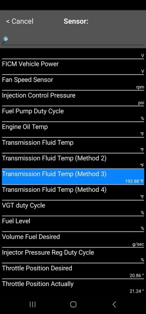

The Car Scanner ELM OBD2 has transmission temp. I haven't messed with the app much so I haven't figured out how to scale the gauges so 100 degrees is not the max.

Ended up getting this. Does everything including all data display coming from the ECU and transmission computer. Of course, DTC, explanation of codes, remedies etc. It auto detects VIN so it is model specific for exact features and sensors. A good deal + for 103 out the door.
I now have real time trans fluid temp display.

The app I use updated and AA support was added. It doesn't show the gauges, just the text.

What app is this and how is it applied?
Car Scanner ELM OBD2, though I'm not sure if there are any features behind a paywall. On Google Play it says "No ads or in-app purchases with your Play Pass subscription", I have Play Pass for free with my Verizon Wireless account, and on my phone the app is Car Scanner Pro when I open it. Otherwise, you just need a BT OBDII adapter and have your phone connected to both that and Android Auto. I just noticed today it was added as an available app.
