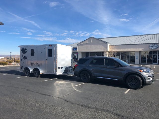

I know this is an old thread. Although I have a '21 Limited, I have lowered it with Steeda springs, Steeda Pro Action shocks/struts and Steeda sway bar. I tow a 4000 pound 7.5x7x16 aluminum cargo trailer I converted in to a camper. With the new suspension, it tows remarkably better than stock. The Limited is obviously sprung softer than the ST but the Steeda suspension does great. 1.5" of rear squat with 450 pounds of tongue weight.
Also have 285/60/R18 Toyo Proxes ST3 on Black Rhino Boxers 18x8.5 +12 offset. This also helps a bit as the track is wider and the tires better than the stock Michelins (255/55/20).
That's a really good looking wheel/tire setup. Do you have any rubbing issues?
No rubbing at all. Was the tallest tire (31.5") that could fit with no rubbing. I tried a 275/65/18 (32.1") AT tire and that rubbed at the back of the fender well while turning.
