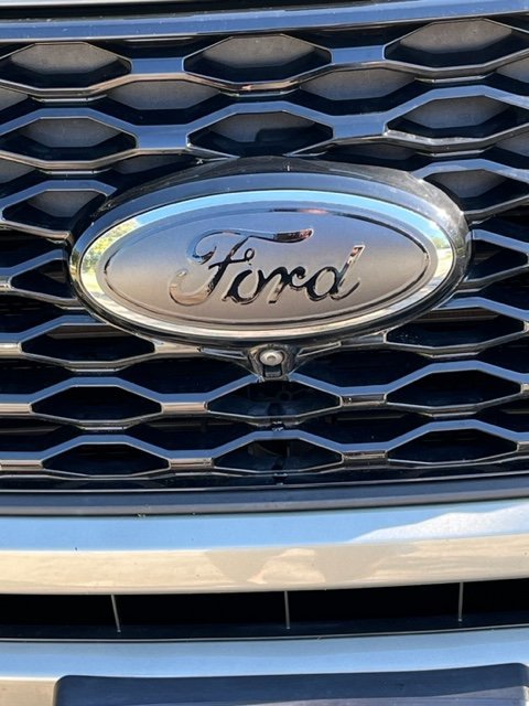

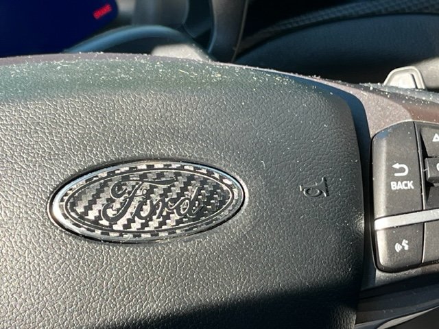

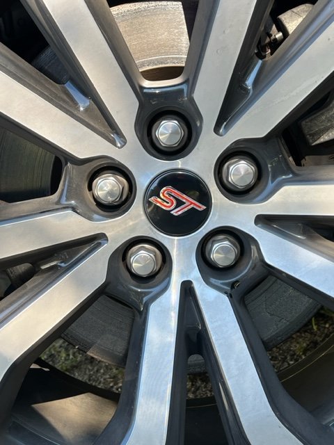

Parts have started arriving! Did my first upgrades today. I hope to get the hood struts and catch can installed tomorrow. Lowering springs and sway bars are next. Then turbos-back exhaust goes in. Gotta wait until the first of October for the intercooler install. Then the best part goes in: the DMS tune from ZFG! I'm hoping Santa will bring me some new wheels for Christmas
