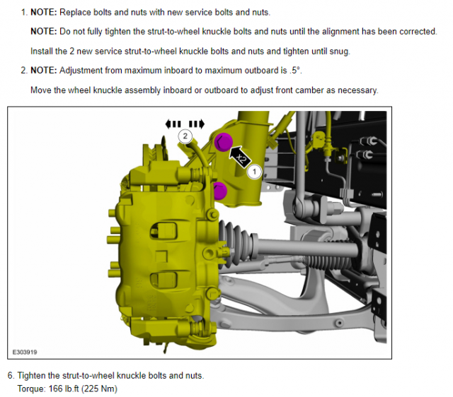

Those with coilovers. How are you modifying to adjust camber
Eh69758
Firefighter
29
Baltimore
Explorer ST
So I’ve seen a couple people change the top bolt hole. But how? Is it drilled out. Using a die grinder. Changing top mounts completely. Camber bolts. I’m ok to just use them as is. But if there is a way to modify them that doesn’t create big problems then I’m down for a set. Also I’m not good on spring rate but is 12kg going to be too stiff and bouncy?

Do you have a part number for them.
I used these bolts to allow for more adjustment not sure if I really needed them, recommend trying the splined bolts first, these are 10.9 grade front suspension bolts but are not listed for use on the ST.
W715295S439
