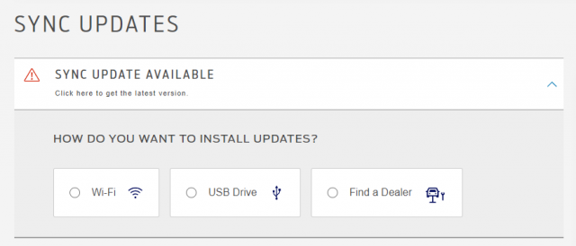

#48
That looks like a screen shot from his Ford Pass app or account.

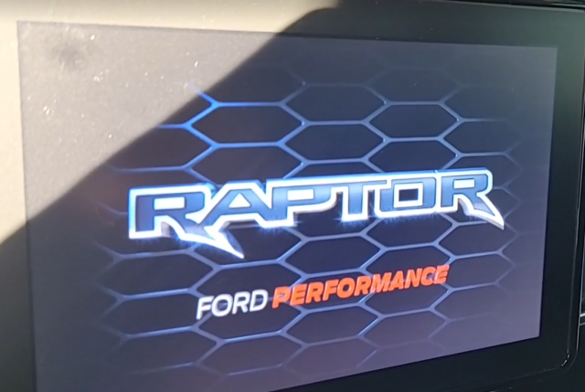

I found out how to change the Ford Sync Theme yesterday.
Oh that’s pretty cool. I’ve seen that done on previous gen explorers too.
