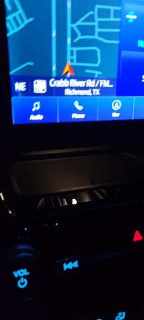

Did you install the LED light under the screen?
I didn't know there was an LED under there.

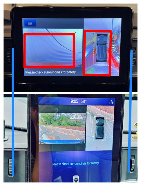

Camera and car play is full screen.
R2D2
293
210
LA, California
I couldn't measure it with a tape. So just used the air volume knobs on both sides as a rough reference to see the difference.
The red squares are roughly the 10 inch camera window sizes. So it has indeed grown a good bit.
Same with the car play.
With that added cubby below the screen, I would say a worthy up(down)grade. I would definitely try this, provided I can get those parts from a salvage yard.
