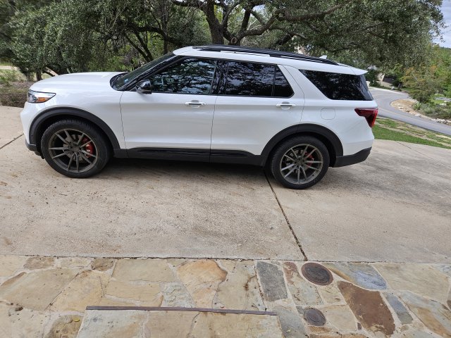

Any pics of your set up
Yes, even though its a dirty mess.. Here it is..
