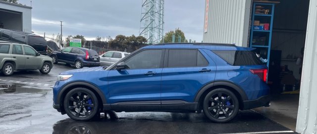

*Looking for color comparisons, I just ordered blue/black.

Welcome to the club!

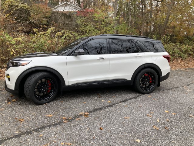

I do like the new kit with the integrated parking brake. The extra rear caliper is why I went a different route.
Average ST
Fremont CA
I like the wrap on your ST, huge difference on the white!! My next minor cosmtic is simply wrapping the blue between the rear door and the cargo in black, leaving the top blue.
