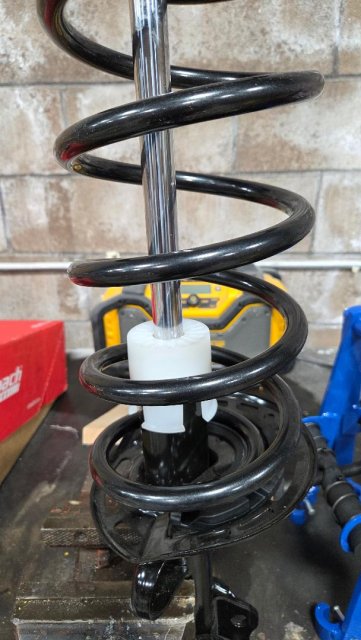

I'm probably answering my own question but does the white strut body cap need to be removed before I put everything together? I looked at my OEMs and they have it installed too, I was under the assumption these were on here for shipping purposes?

Leave them on. My original struts had them when installed.

That's what I thought as well, I just found out ford uses them as a integrated bump stop (OEM Struts), I also forgot to mention the new struts are the steeda pro action struts if that makes a difference, I know they are re-badged OEM ST strut bodies. The research I'm doing is saying remove them.

I believe their purpose is to stop the bumper from contacting the shaft seal when fully compressed.
They’re not just rebadged strut bodies…they’re rebadged struts. Steeda changes nothing at all.

Was also thinking if it were meant to be removed, why include it in the first place. It doesn’t appear to perform any type of protection during shipping. You know the penny pinchers would eliminate it to save the ten cents

That's what my thought process was, I'm going to go look at my current strut installed now and lift the boot more to see what the current cap looks like, if its not a holder for the bump stop or whatever ford says im probably going to just keep it on the steeda strut.

Much to do about nothing. It belongs there. Leave it on. It doesn't hold the bumper, it stops the bumper from crashing into the seal and damaging the seal under full compression.

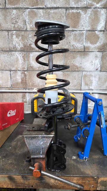

A little off topic but, I'm assuming this is the correct orientation so far? I'm just waiting for the dust shield. The bump stop just "floats"?
Unable to really compare due to the old strut being on the ST.

It holds the lower part of the boot in place.
Ahh I see! thanks for illustration. It looks like the bump stop gets pressed into the top hat as well? I have it upside down it looks like in my picture, for the life of me I tried pressing the bump stop into the top hat before I flipped it facing the way it is now and I could not get it to seat.
Got the bump stop in, just needed some persuasion lol, just waiting for the dust boot then should be set to install everything. Thanks for the help guys!

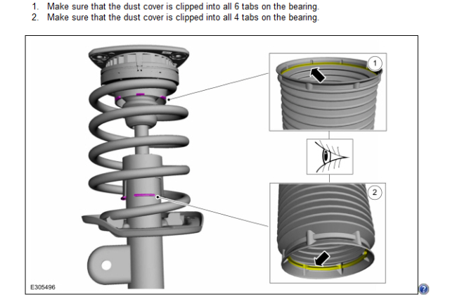

5,627
6,801
That thing locks the boot in place and your bump stop is upside down in that pic.
21STBlkout
132
38
New Hampshire
Thread Starter #19
Thanks for the heads up, WaferTech's diagram he attached helped perfectly. Just waiting for the correct top hat bolts to finish putting everything together.
