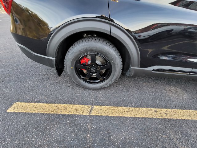

Here are some close ups, the rim is pretty close to the calipers without touching. 20201022_112556.jpg

Odd. I ordered a year ago and the Tirerack website returned quite a few 18" rims, but by no means, all 18's that they carry. I think as long as your offsets aren't out of line and the wheel bore is large enough to fit the appropriate hubcentric ring, it should be fine.
The KMC KM708 i got from Tirerack were 18x8 38mm offset and clears the calipers but come close.

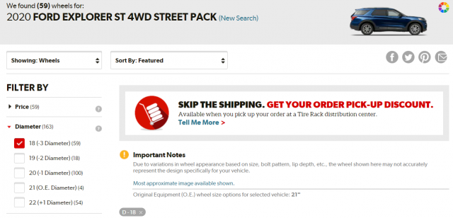

I've used them many times in the past and their filters take into account different options/packages. I also see 59 wheel options in 18" when searching for a 2020 Explorer ST with Street package. Great choice in tires. Blizzaks are my go to winter tire. Nice wheel/tire package!! I went with 20" and a 255/55 tires (waiting for them to come in). 1603391283139.png

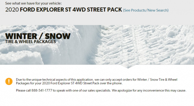

Pick Winter Tire and Wheel Package and you get this:
You are correct. I just got the same message. I ordered mine as a package as well and it showed tons of options in all sizes before. Now you have to call in. Hmmm...:unsure: I will say that the Blizzaks never showed up for me before due to their load rating (is what I heard) when putting together a winter package. I had to call in because they came in the size I wanted when just searching for tires. My rep said their filters are very strict with the recommendations.
