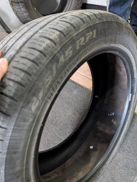

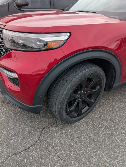

Just curious if anyone has experienced this. 2020 stock ST 46k miles. Had lionhearts 295/40/R20 installed today. When they removed the old tires they found the attached in the 2 front tires. This explains the very unpleasant ride. Unfortunately found both front CV boots are torn.
