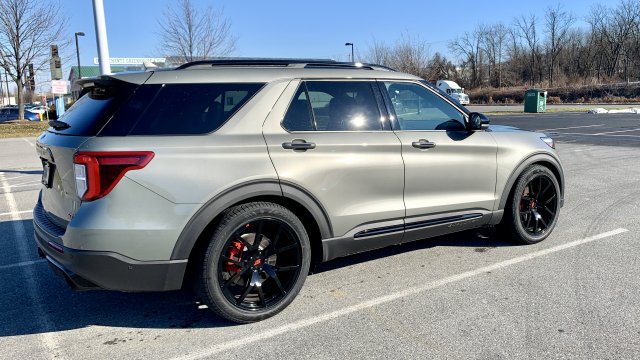

Yes. See me. Make sure you run +30 offset. I originally went with a +35 offset with 305/40’s and there was a very slight rub. Not much. I added a 6mm spacer. (Thanks to Unbroken!) C8DF1ACC-5B57-4FCD-A0D5-45A77D43E3E8.jpeg

Like those wheels! Look custom with the ST logos. Is that a '21 Carbonized Gray?

Thank you. This is a 2020 Silver Spruce. The color is no longer available for 2021.

Yes. See me. Make sure you run +30 offset. I originally went with a +35 offset with 305/40’s and there was a very slight rub. Not much. I added a 6mm spacer. (Thanks to Unbroken!) View attachment 3166
Did the rubbing stop with the spacers? Did you get longer studs or did the normal ones work?

Actually there really wasn’t any rubbing. No marks on inner well. However, when pinned it felt a little too close for me. Added spacers and now she’s got little more space. No issues. Lesson learned.

Sorry if I was confusing. I should rephrase for clarity and because things have changed since I posted this. My wheels are +35. I also am running a 305/40r22 which is a full 1” larger than 305/35’s. This caused me to worry about rubbing at full turn so I put on 6mm spacers to push she wheel out a bit. This would mirror the look of a +29 offset. After some testing I removed the spacers and stayed at the natural +35 because I was not rubbing at all and liked the front wheel position at this offset. The rear wheel still tucks. If I was running 305/30’s I would never have put on spacers so for me it was all about the tire and not the wheel offset.
From my experience and opinion the offset I will run in the future is +35 up front and +30 in the rear.
