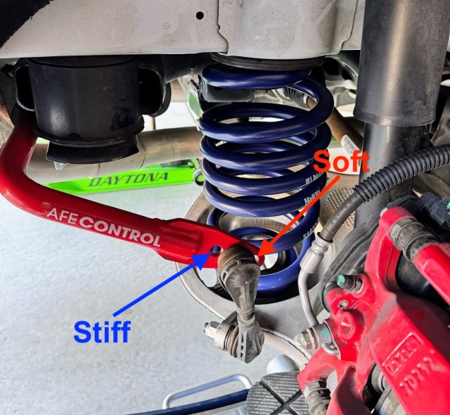

I am assuming the firmest setting would be the 3 whole?

The hole furthest from the end of the bar.
I thought the hole furthest from the end of the bar was the softest setting. At least that's what Steeda says on they're website.

I’m fairly certain the hole closest to the bar is the stiffest setting, which makes sense when you think about it. The hole farthest from the bar would be the softest.
I went with the middle setting. On a curve I drive every day, pushing it a bit, I was able to carry about 5 mph more than before. I also noticed that if you add too much steering input after the install, the car will really dig in and respond more abruptly in the direction you’re turning. It definitely took a little getting used to.
Absolutely not. The outside hole is the softest.
