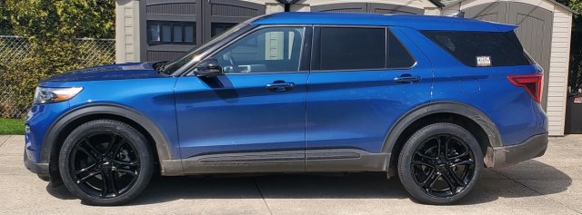

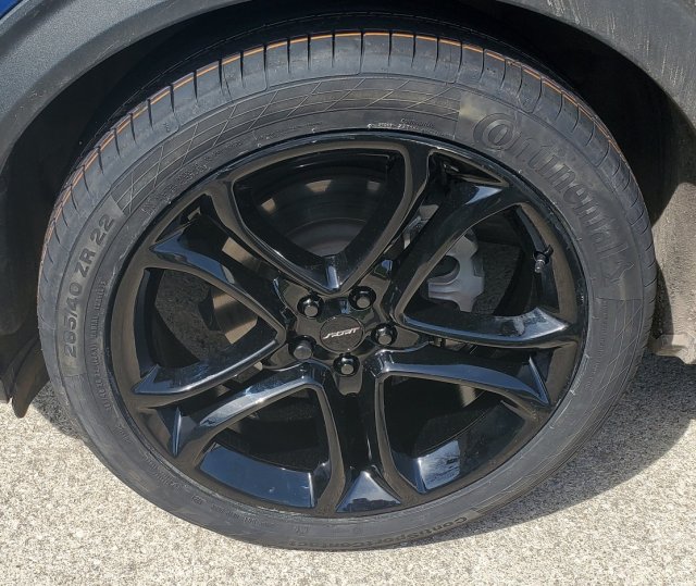

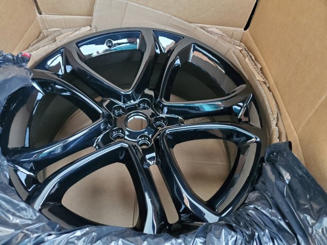

Those look sweet, I love the look of OEM wheels. I did some thing similar on my first ST. I always liked the look of the factory 22's on the 13-14 edge sport so when I found a set already powdercoated in black, I had to get them. I had the hub bore opened up to fit the ExST because the second gen edge used a 63.4mm hub bore and our ST's use 70.5mm. I still have the wheels, when my 21" tires need replaced, I'm going to put new tires on the 22's and run them again.

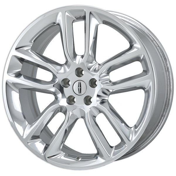

I think these wheels would look good upsized to fit the explorers
The first gen edge had a 22 also and they have a 70.5 hub bore so they bolt right on our explorers

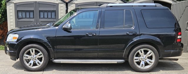

and the 2006-2010 explorers had a 20x8 wheel that would look good upsized to a 22
