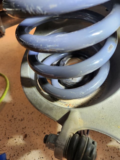

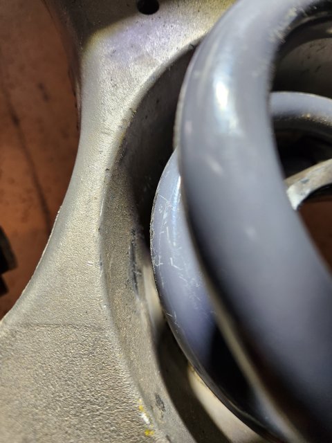

I took my rear-end apart today to check everything and found what was causing the noise. It is the second coil from the bottom hitting/rubbing the inside of the aluminum control arm seat, see pictures. I think that there is something off with the manufacturing of the springs as they sit offset in the bottom isolator. My isolators were installed correctly and all bolts torqued in the loaded position.
1,678
1,421
That would do it. I'm glad you've isolated the problem. I wish your resolution didn't involve replacing them.

I checked out the rear end yesterday and was able to push, with a prybar, the bottom of the springs away from the lower control arm seat where it was hitting. The spring and bottom isolator were aligned properly but just seamed to be off-center or the second coil is just too wide.. I went had the ST realigned again today and as of now they are not hitting and making noise. I don't know if they will move but just want to give an update.
Thanks to @Lethalperformance for great customer service.
