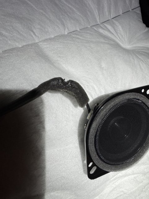

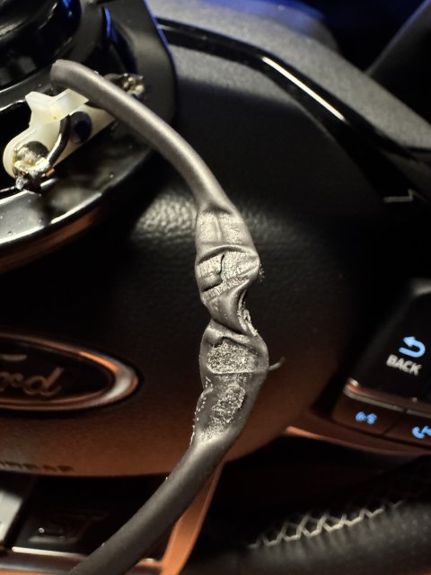

Hey y’all! Had my 23 for about 15 months now and went through doing a 2 stage sound deadening on The Doors and rear sides/floor/hatch. Got to the front door, installed everything and threw the panel on. Wasn’t until I was running a post install staging calibration and found that the mid range driver wasn’t getting audio. Sincerely thought I messed it up, but after pulling the panel off and taking the mod off the door panel I found it looks to have been pinched when installed at the factory. Patched the cable and finally have a decent front stage (with enhanced chime tone and volume lol). Triple check all your speaker work if you haven’t already. May just make your day!
