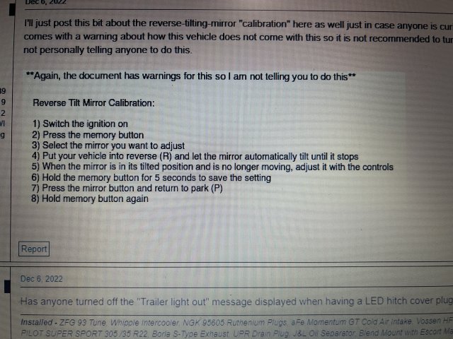

Didn't know about the reverse mirror capability. Sounds pretty cool, gonna try it on mine later.
Yes, I had it on my BMW for the last 10 years. It’s a rim saver here in New York City when you’re trying to park.
after you said it in FORScan, there’s also a procedure on setting the memory buttons. If you search on one of the posts, it lists out the six or seven different steps you need to take.
As a matter of fact, I took a snapshot picture of it with my iPhone, so I had it in front of me when I did the setting. Here is the picture. 694EE6C9-D642-4CF8-A4E5-7EE6AEE6271A.jpeg
