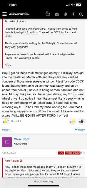

IMG_7691.png Possibly a way to electronically disconnect the from axel, a plug somewhere? Any charts anyone has or wiring diagrams would be helpful! I’ll share the results if I make it happen

All power always goes to the rear. It's only the clutch-operated front wheel drive that's controlled. There may be some way to disable the FWD clutches.

You could probably build a box as the OP described to intercept the signals to the actuators and set the clutches as desired while feeding back signals to prevent alarms or error codes.
This is exactly what I’m trying to do. The program for BMW’s was xDelete and you could custom set the clutch values. Most of those clutch’s can never fully disengage so there’s always a 1% or fraction of a percent of power going to it but it’s small enough you’ll never feel a difference between true rear.
I know some cars have a fuse that’s pull-able to disable them as well and lock the car into rwd
I just wanna find an “easy” way to do it before I go doing sonthing crazy
