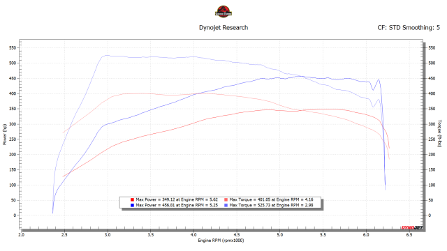

I'm currently tuning ~20 of the new 25-26 cars. They do very very well.
This was the last one on the dyno!
+107hp with an intercooler + intake.
