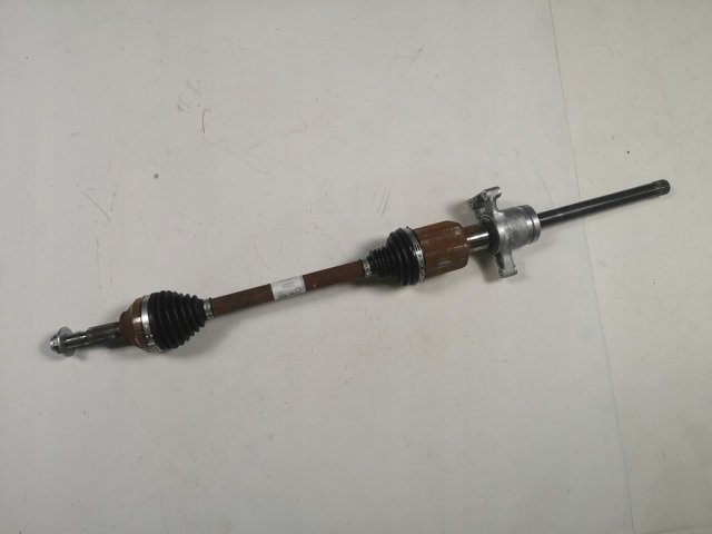

I can tell you 2020 ST axles did not come with "corrosion protection". And no, the part number will not be the same as MY2020. For one, the axles on MY2020 and early MY2021 were flawed and tearing open left and right at the bellows clamp. The replacements had a different bellows design and had different part #s. Two, the front axle disconnect actuator was replaced with an intermediate shaft sometime MY2022...the drivers side axle will not be like the earlier models. Lastly, MY2024 are unlikely to be cobbled together from misc old parts because mechanically, MY2025 are likely mostly unchanged.
2,065
1,043
2026 Explorer ST
Here is a N1M7-3A428-AA on a newer Explorer connected to the new version intermediate shaft. Note that the inboard end of the halfshalf is female and the intermediate shaft has the splined male end. That is completely opposite of a 2020 halfshaft. Also note that this is likely a MY2023 or MY2024 and it is covered in surface rust.
