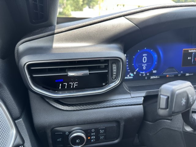

I was alerted to this when I was programming something via ForScan, but it showed a pending DTC for a P0128. Accidentally erased it unfortunately. But decided to monitor coolant temps for a bit and noticed i run consistently 172-177 degrees. Only once did I ever see 205 degrees. But 99% of the time i'm at 175 degrees on a 95 degree humid day sitting in traffic. On cool mornings and evenings, I run about 172-174. From browsing threads, i see i should be running around the standard 200 degrees that modern EFI engine normally run at. Coolant level is good.

BTW these P3 V3 gauges are nice for this sort of stuff.

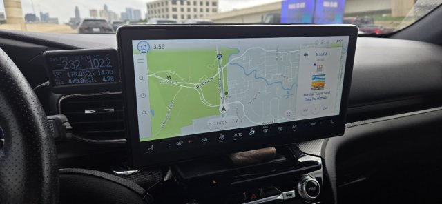

You are fine. My ST run at 176 to 177F.
In the winter with A/C off, Sitting in traffic. Temp get to about 210F before the radiator fan kicks in.

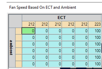

This is from my Ford Flex. The Fan turn on at 223 with A/C off.
