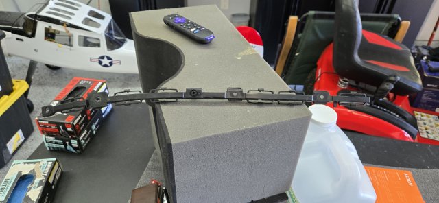

I had this leak on the driver side for about 3 months now.
Removed the Driver Side A pillar and other driver side trim.
Ran a water hose around the front of the windows shield until I see the water dripping.
Found out the water was leaking from the roof trim bracket.
Pry up on the front of the trim to disconnected it from the taps.
To get access to the 2 10mm bolts, you will need to drop the headliner. See Houston Speed Freaks Explorer ST Roof Rail Delete
All 4 was the gasket are hard like a rock.
I removed this gasket.
Add Black Silicone around all the bolt holes.
Reinstall.

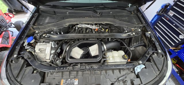

Your issue isn't the roof rails leaking, Your issue is the trim panel over the battery under the hood on the passenger side, If that panel is not snapped in correctly at the base of the windshield, water will get in and puddle in the passenger footwell.
Just checked it and Definity was not attached properly thanks for the reply!!

Most likely it was the battery cover. Dry out your interior first and make sure it doesn't get wet again before you go digging around for the drain hose.
