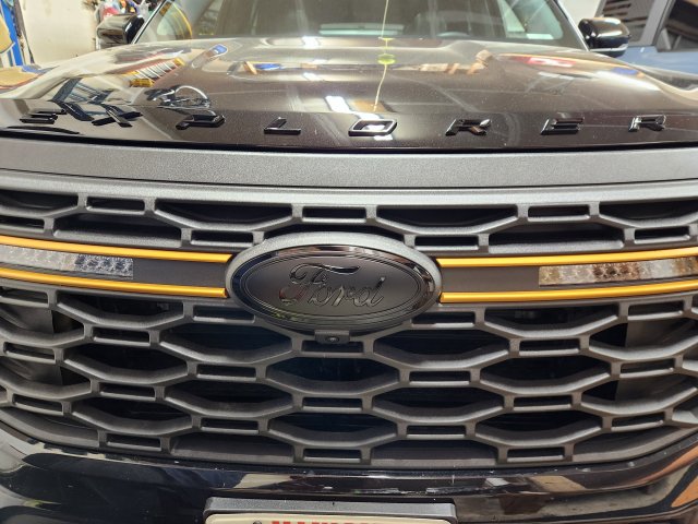

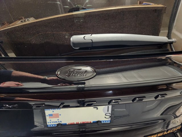

@DaGooch: Thanks for the ratchet-on-a-string tip. I thought I could use the low-torque flexible drivers but I was wrong. The 1/4" ratchet with 10mm deep-well socket worked. About100 cycles given my fat fingers, but it worked. I was able to install the black Ford oval. The rear was easier.
I went with the subtle change using the Ford black emblem.

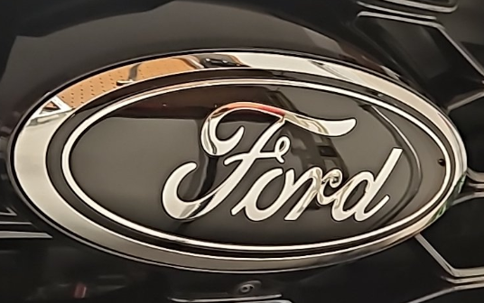

I love this style oval. Wish these came OEM on the ST
I need to find one for the steering wheel now. Black background, but same chrome outline and Ford script.

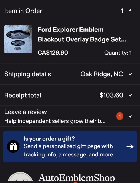

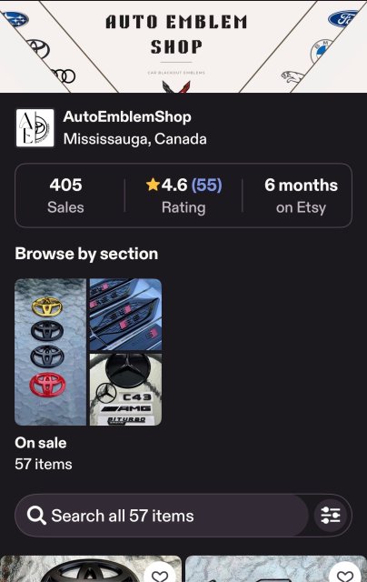

Etsy - $103.00 three pieces (steering wheel, front and back) these are metal not plastic - PERFECT fit no anxiety install ... Looks awesome on my ST and a whole lot cheaper than Fen Fab made in Canada ships from Canada ...

I see them, but can't find the style I want. I want the same as the OE oval, but just with the back background. I still want the chrome.
This with black background...but for the steering wheel. If someone can find that combo i would appreciate it.
