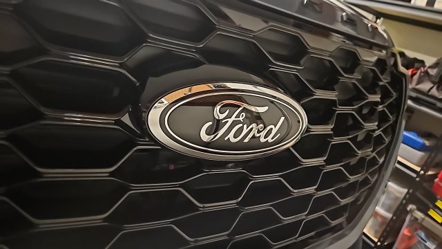

@DaGooch: Thanks for the ratchet-on-a-string tip. I thought I could use the low-torque flexible drivers but I was wrong. The 1/4" ratchet with 10mm deep-well socket worked. About100 cycles given my fat fingers, but it worked. I was able to install the black Ford oval. The rear was easier.
I went with the subtle change using the Ford black emblem.
It looks great! I am thinking I need a pop of red in my black emblem. The contrast is just not enough to see that it is not just a black oval. I am thinking about masking it off and plastidipping the word Ford in red. At least, that is the wife's suggestion. Not sure though, I guess I'll spend the $10 and try it, if all else, I can just peel it off.

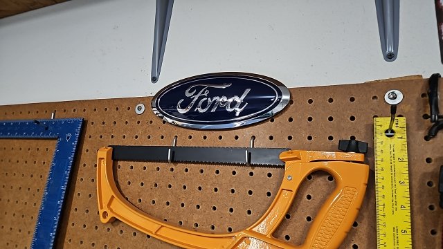

Thanks, worked like a charm, the string is a must.
And the blue one presses right into peg board.
