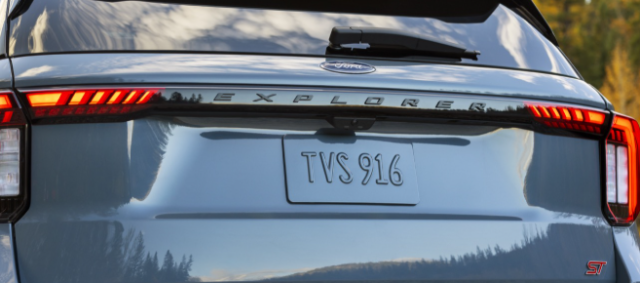

I'm considering removing the explorer lettering from the hood and from the rear liftgate of my 2025 ST. I've found threads about removing the hood letters but cannot find anything on the rear letters. Just trying to confirm there's nothing but adhesive holding them on and if anyone else has done this. Thanks for any help.

Are you referring to the explorer lettering between the taillights?
I believe that is part of the trim, but I am not 100% sure. Curious myself now.

Those are just adhesive too.

Yes, that's correct, the explorer letters between the taillights. I've found some facebook threads of people saying they come off easy and at least one guy that said he damaged the taillight bar doing it and that it's not worth the risk. Google AI says they are held on by adhesive only. Just looking for any experience people have had to see if it's worth the risk. I generally despise those letters on the front and the back, not because they look bad, but because cleaning around them is a hassle and never really gets done right without more attention to detail than I'm willing to put into a regular wash and dry.

The guy who messed up used the wrong adhesive remover. You need to make sure to use automotive goo goo gone.

I didn't even know there was an automotive goo gone and that adhesive is so stuck on the plastic, I'm not sure it would work! Let me just warn you... don't do it! Not worth it! I'm waiting until it gets warm to fix the damage to that taillight from goo gone and rubbing.... easily damaged!

The black plastic is extremely sensitive to solvents and scratches. Anything you remove will have to be polished and there is not guarantee that the adhesive remover used won't discolor it. Proceed with caution, I advise not to though.

Be careful when using adhesive remover on the front as well, alcohol is ok, but anything more caustic might discolor the grill area. I know this because I damaged a small area around where I removed the front emblem.

I’ll tell you, some of y’all really overthink some very simple stuff. Pop the rear emblems off with fishing line or whatever you like, get rid of the adhesive with goo gone then polish back out any scratches you may have caused in the process. The whole project shouldn’t take more than an hour.

Plain old mineral spirits work very well also and it won't hurt anything.

Yep, used fishing line more than once, and goo gone stays in my garage. That being said, I like the "Explorer" on the front of the 2025.
