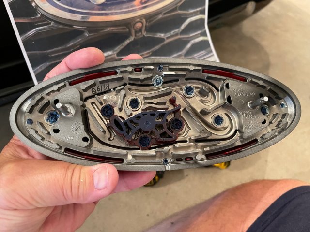

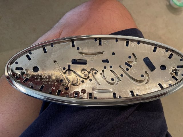

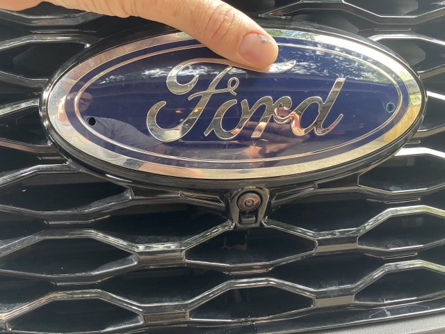

I can answer that question about the grills blue oval. I drilled through the front to remove using replacement oval as a guide. Replacement oval is now held in place with 3m molding tape. Installed the replacement oval way after the intercooler was installed so not interested in removing the front grill/bumper again. Using tip from Unbroken ;) drill through the front to remove stock grill oval.

Where did you get your badges from? I was planning on doing the same thing. Really don’t want to take off the front bumper to change out emblems.

Take a look for @UNBROKEN's shortcut on installing a front Ford oval and see if that is something you would like to do. It is no doubt easier than pulling the grill. In essence, you would be drilling the original studs and using double-sided tape to hold the new one on.

Can you please tell me who did your custom oval?
