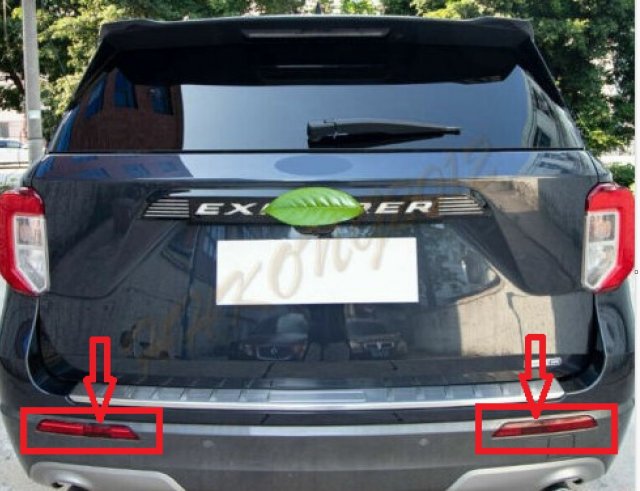

Hey there Ataraxia... So Yes I did order the parts and received both sides... However, only one side (Drivers Side rear) has LEDs
the other side is similar in design but no LEDs and missing/sealed connection for prongs....
That being said I am seeing 2020-2023 NON-OEM rear LED fog lights being sold on ebay and such...(see pics) and
actuall this is what I was looking for in the first place - Hoping FORD / OEM would be what I needed... oh well
