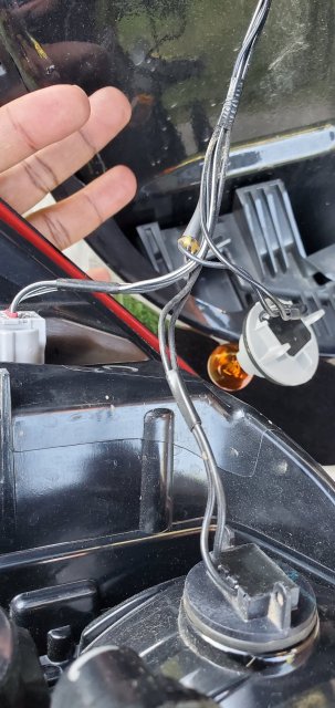

I have set of these but I don't know how to wire them up? I've had these on my 17' Fusion Sport for the past 4 years with no issues. So if anyone is pretty good with the wiring of our tail lights, please chime in! I provided pictures of the wiring of the tail lights and of the lights on my Fusion.
No directions? I would suggest wiring into the trailer harness if you have one. I'm not sure I would go into the wiring of the taillights myself.

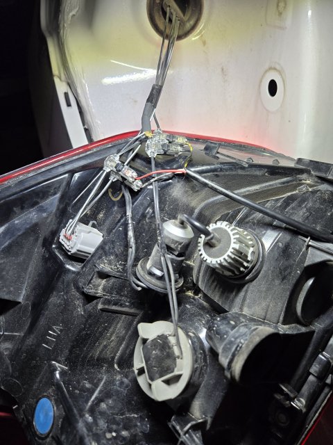

They sent me the wiring directions via email. My Fusion LED bumper lights are wired into my tail lights as well. Here's how they're supposed to be connected:
green wire connects positive taillight running terminal
red wire connects to the positive taillight brake terminal
yellow wire connects to the positive taillight turn signal
black wire connects to any negative wire
So if anyone knows what the wiring scheme is, please let me know.

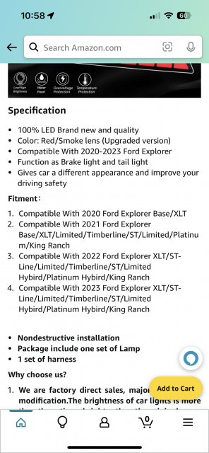

Had these on my Fusion Sport as well and they were awesome. Did not come with any wiring instructions but luckily someone else who purchased them on Amazon had gone through and checked the wires. Those instructions show three wires and you've got four so just some trial and error would find real quick and be same for both lights right?

Yeah it's weird, the ones on my Fusion Sport has 4 wires but the ones for the Explorer on Amazon has 3. I got mine from Ebay, a seller in China because at the time, I couldn't find them for the Explorer for some reason until after I got mine delivered. So now I just need to know what are the positive/negative wires on the Explorer to get them installed.

Unfortunately, mine didn't have them included. But I think I have a solution for them now? I'll post up when I'm done.

I wired the bumper lights to the flat 4 trailer hitch location. They work but it disabled my BLIS since it thinks I'm towing. The video file is too big to upload. I'll see if I can trim it.

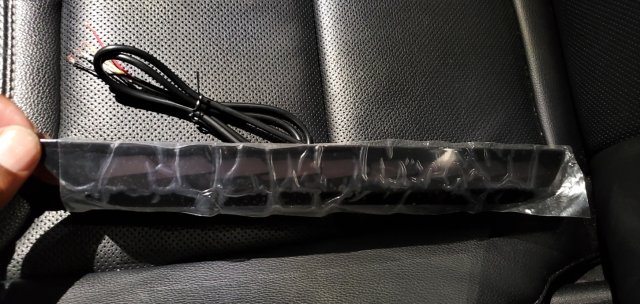

Here is what y'all asked for.
