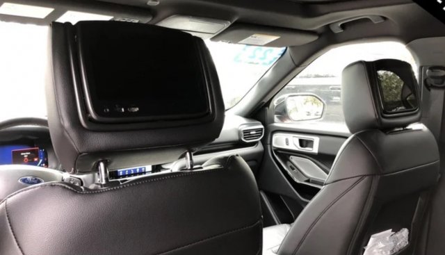

How do you use rear entertainment system without the dvd , mine doesn’t have one and I have tried to use it and cannot figure it out.
i have 2022 ford explorer king ranch and dealership was no help.

HDMI cord from your Android or Apple device works.
You can Bluetooth from your devices as well but it only plays video and photo files from your device - can't stream downloaded Netflix, Vudu, or other movies and such so pretty pointless.

We have rear entertainment in our Forged Green 2023 Explorer ST.
Will be using 2 SDXC Cards in SDHC adapter (comes with larger card adapter) for $34.99 each in Amazon. (SanDisk 256GB Extreme PRO SDXC)
One card for each kid.
With HD movie downloads being at most 4GB, that would be 64 movies.
You can download digital movies and put them on the SD card. You can tilt the screen forward and the SD card access is on the left.
