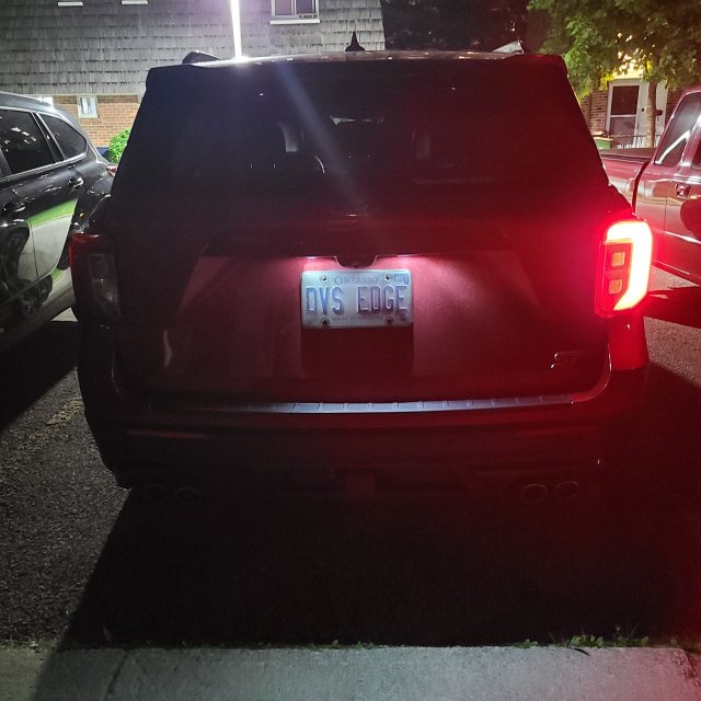

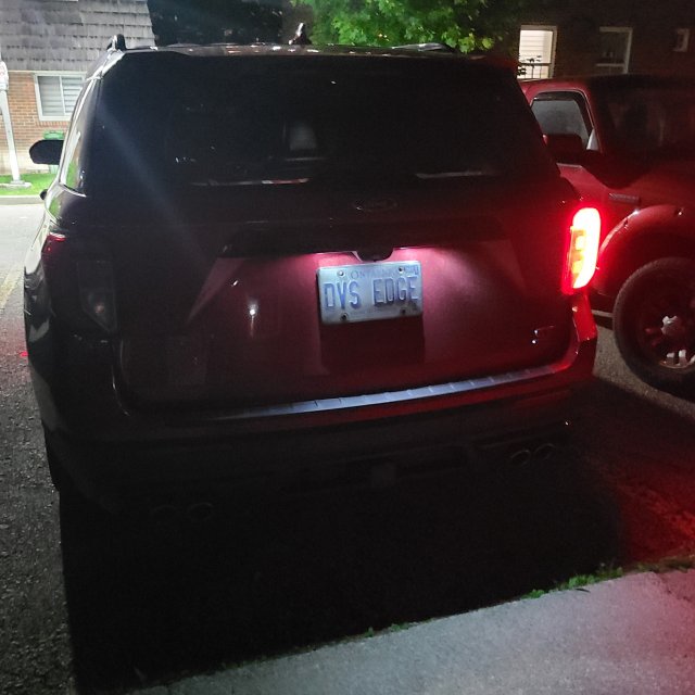

Here is 2 pics of the problem that I,am having. I've unplugged the tail light & it did nothing. I also unplugged the light switch & that did nothing as well.

I think all the lights run through the BCM. I have seen posted where you can reset the BCM. To do this disconnect the battery cables . Then touch them together to drain any remaining current. After that wait a few minutes and connect the cables. It might work and is worth a try I think . Good luck.
2,057
1,042
2026 Explorer ST
Did you verify that the backup light and turn signal light don't work? those are on bulbs. if only the brake light, your tail light is likely the problem. if everything, bcm. Any error codes on a scan?
