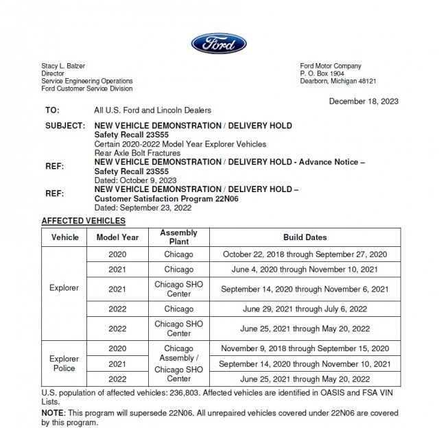

For those interested in the chronology of how Ford works these recalls...
It seems Ford originally considered the EPB auto engagement a fix to the broken bolts. PIU's were getting new bolts & bushings because they use a cable park brake and the software fix obviously wouldnt work. Seems Ford considered the potential for roll-away to be the problem, and not the actual bolt breakage. At least until the number of failures grew.
Not hammering Ford, just found the history and chronology interesting.
We havent gotten a letter yet, but according to the NHTSA website (https://www.nhtsa.gov/recalls), the latest says parts are now available.
Edit: Also interesting that this doc begins in April of '22, and thats the cutoff for the recall. So they did make a change very soon after they knew they had a problem. Even with one as statistically small as this one.

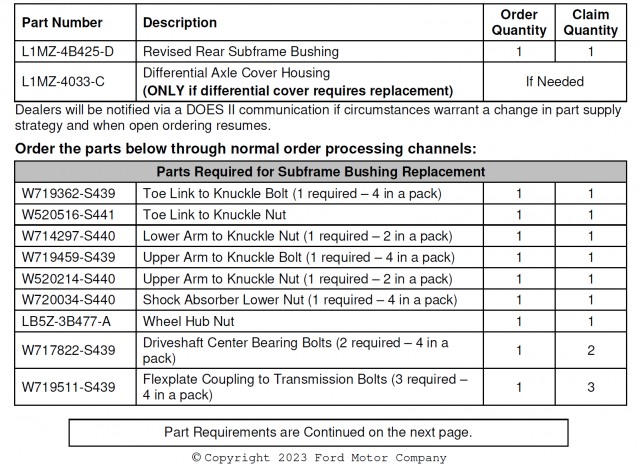

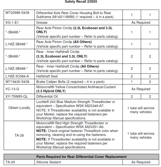

Here is the PDF of the Ford Recall services.
Ford is replacing any bolt that is removed.

... It seems Ford originally considered the EPB auto engagement a fix to the broken bolts ...
I don't think anyone believes that FORD considered the EPB a "fix", just an emergency procedure to prevent roll away until they got a handle on what was what.
The updated recall 23S55 shows the latest date for Explorers that need the fix is July 6, 2022 (my ST was made July 7th and has the fix).
