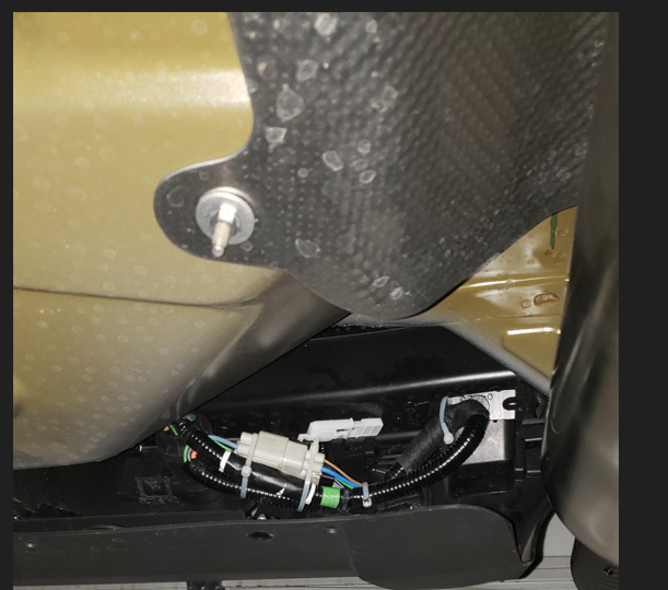

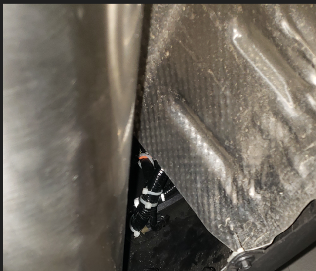

Try checking the rear corners under the bumper, my parking sensor connectors were rattling, and the class 4 hitch connector.
Driver side rear parking sensor under the bumper
Class 4 Hitch connector under the bumper.
