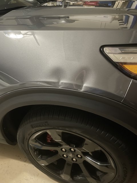

Ugh it happened! someone (no one will own up to it) pulled in a bit to far in my wife's car and bumped the shelves in front of the car. Anyway 2 tables fell and of course landed perfectly on my passenger side front fender. Has anyone used a pre-painted company to just have an OEM fender painted and shipped? It appears pretty easy to replace the whole piece and would save a ton of time bringing it to a body shop. Only thing I dread is having to remove those two pesky bolts with tons of locktite on them that attach to the front fascia. I had to remove those for the whipple intercooler. Any advice would be appreciated.

Unfortunately the paint did crack at the lower seam by the plastic flare/molding. I have a great body shop but they are booked out 3-4 months so I was looking for a quick fix. I just hate cleaning up all the overspray every time I had a portion of the car fixed. It has been 2 decades since then but I don't know if the procedures have improved. Hell I ordered the bumper plugs for the license plate and they are a perfect match. Just trying to figure out best route. Money is not an issue but time down is.

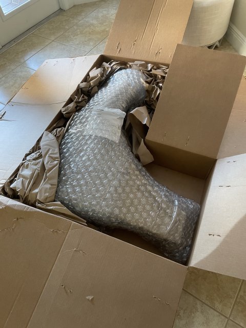

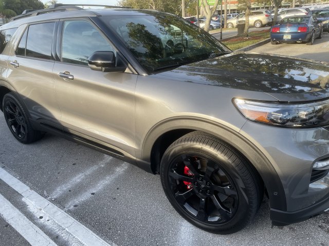

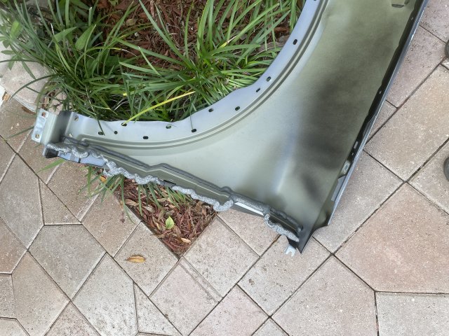

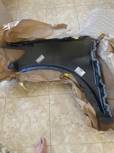

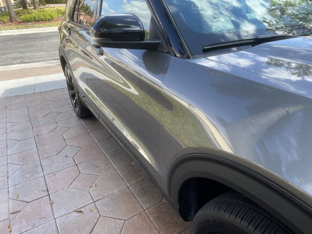

OK I received the new painted fender and installed it. I ordered the factory OEM part. Everything was well packaged and very communicative. The paint match is probably 9.5/10 but still better than a dent or having to rent a car for 4-5 days at a body shop. I now know why the front fenders stick out a bit at the door line. It is this foam stuff that is in between and is not very pliable. You do have to remove the front cowl and headlight to do this job but pretty well engineered part from ford with slip in attachments.

Looks good. At least you were able to do yourself without having it in shop for a week or 2.

Yes that is where I ordered it from. Super communicative and a pleasure to deal with. There are several companies that do this but ReveMoto had really good reviews. They also give you the option of factory OEM or aftermarket. They obtain it from a dealer. Yes the OEM is more money but with a new vehicle it is wise.

I did not but I know the good places are sooo backed up. I know this because my daughter messes up her brand new VW. The cost of parts was the same as I researched but we all know labor costs can escalate quickly. At $700 total with no down time was so worth it to me. I figured I would give it a chance. Only took a couple hours to R&R. They even sent a touch up paint, cleaner and a brush. I was worried about paint match but they guarantee it 100%.

I have the same issues with my fender to door alignments, did not want to take it in to have it fixed, gonna unbolt it and do it myself, good to see that the fender was not glued in place. Thanks for the writeup!

The front fascia need to be partially removed as there are 2 bolts securing the bumper cover to the fender. I basically followed the install instructions for the whipple intercooler, then located all the bolts securing the fender. Looks like the above post covers everything. Thank you! The time from order to arrival was less than 3 weeks.

That fender .. on here looks like a dammm good match
Very neat you can order a painted part and have her ready in a few days.
