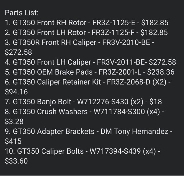

Here my parts list.
Part #
FR3Z-1125-E RH-Front Rotor
FR3Z-1125-F LH-Front Rotor
FR3V-2010-BE LOADED CALIPER, FRONT RIGHT
FR3Z-2B120-G
FR3V-2011-BE LOADED CALIPER, FRONT LEFT
FR3Z-2B121-F
FR3Z-2001-L Brake Pads Front
W712276-S430 Bolt Banjo (x2)
W711784-S300 Brake Hose Washer (x4)
W717394-S439 Caliper Bolt (x4)
GT350 Adapter Brackets - DM Tony Hernandez
Caliper Retainer Kit
GT350 Brake Hardware Kit - Front for $29.99

Where I deviated from that list is:
Note: the calipers are on backorder so try to find a pair at a local dealer or check Ebay for a used set. LMR sells a new set of calipers (base black and R red) and rotors but they are far more expensive than if you can find them at a dealer.
