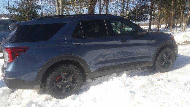

2020 Street Pack wearing its "cheap" winter shoes 18x9 American Eagle 901 w/ 265/60R18 Goodyear Wrangler Duratrac
New Mexico

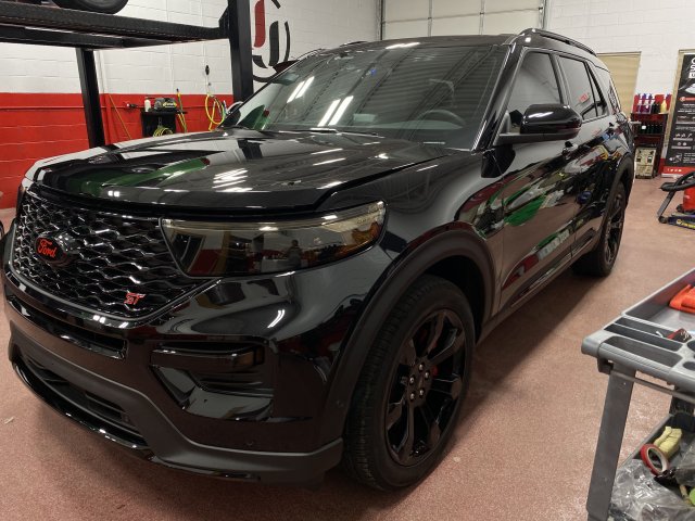

My wife’s ST
  • Full Front Xpel Paint Protection
  • Gloss Black C-Pillar Vinyl Wrap
  • Color Keyed Badging (Ford/ ST)
  • Husky Liners
  • Billet Pedal Covers
  • Rear Wiper Delete
  • Black Lug Nuts
  • Explorer Lettering Rockers Expolrer ST #1.jpg Expolrer ST #4.jpg Expolrer ST #5.jpg Expolrer ST #7.jpg Expolrer ST #8.jpg

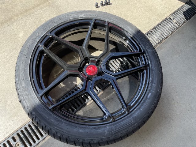

955
655
Wheels - 10.5x22 +30 BC Forged EH309 Gloss Black (maximum concavity BC Forged determines) with Tires - Pirelli Asimmetrico 305/35ZR22.
