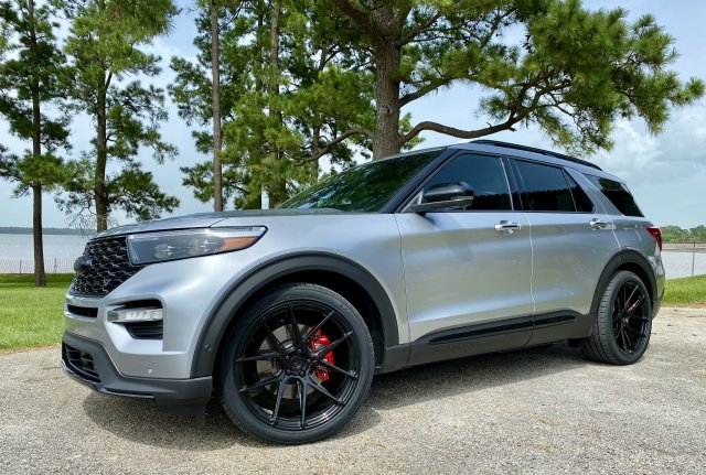

I just posted a pic of someone running a 22x11+38 running a 305/35/22 tire and you are telling me no one is running it. It’s easy to verify the tire specs to see the difference in tire specs
I have pics of their inner barrel and tire to verify. I would put money on it working with the Ferrada’s too if your offset is +38 which it very likely is. You can determine the offset yourself using the method I posted earlier in this thread.
regardless my point is 305’s are absolutely a possibility.
The offset of the Ferrada's is most likely +28 to +30. Unless you get flared fenders, with this much concavity of the face of the wheel, a +38 would not fit. They are super deep concave. Probably why CM2 stands for "concave madness 2". Heh. I have not seen a wheelset with more concavity for the Explorer ST application, even custom applications. I just know that the offset is much more aggressive than +38.

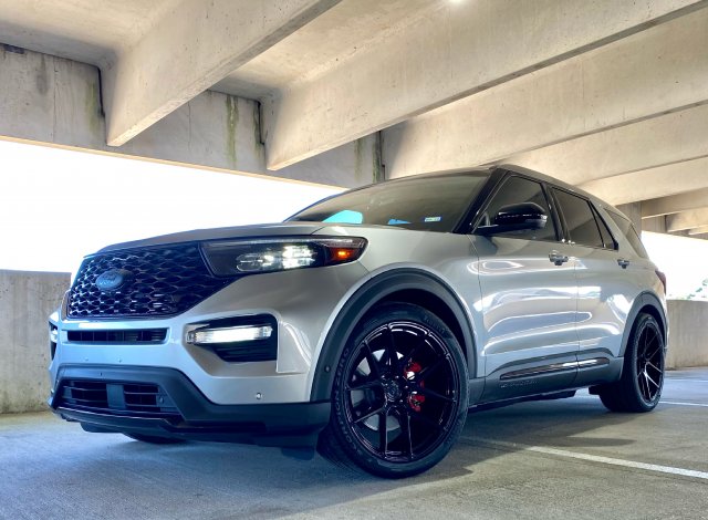

Here are front and rear shots of the car to see how they fit in the fender at +38 for you to compare.
87948E2F-9AD4-4218-9CDB-F7A761ABB41D.jpeg 2454E479-1DF7-4386-95D7-7CE284EC7220.jpeg 3F668648-A4C7-4E58-825C-44A9688CABF8.jpeg

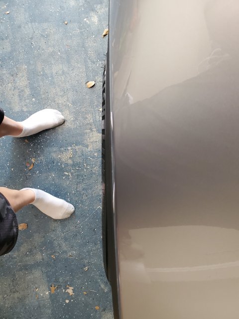

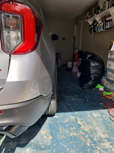

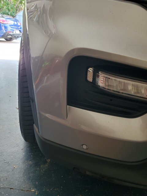

Pictures don't mean anything because you can't see back spacing. But here's pics of mine to compare. Even though mine stick out towards the fender more, there is very little clearance between the tire/rim and front suspension on the INSIDE.
Nevermind my socks and messy garage. The sock pic is the front right wheel/tire.

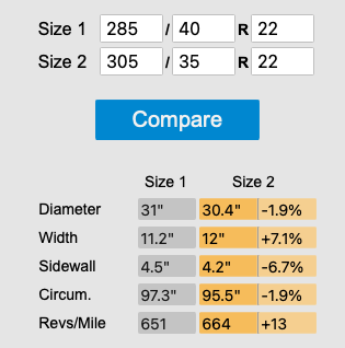

The fact that their rim likely sits more inward than yours means the 305 would very likely fit on the Ferrada's which you say are further outward. There is a substantial difference in diameter of the 285/40 and 305/35 to account for the added width. The face of the rim is the face of the rim, backspacing doesn't matter when you are comparing the position of the face of 2 wheels to a fender.

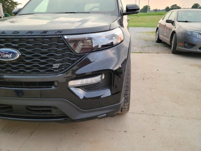

22x11 +38 clearly has no issues running 305/35/22 tires (brand dependent). Whatever clearance the Ferrada’s allow may or may not allow it to work. You run 315/35’s without issues there’s very little reason 305/35’s wouldn’t work with the Ferrada’s unless they are way too aggressive outward. The inward clearance won’t be the issue for him.
This is how close I am with no issues for reference.

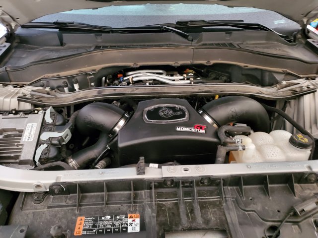

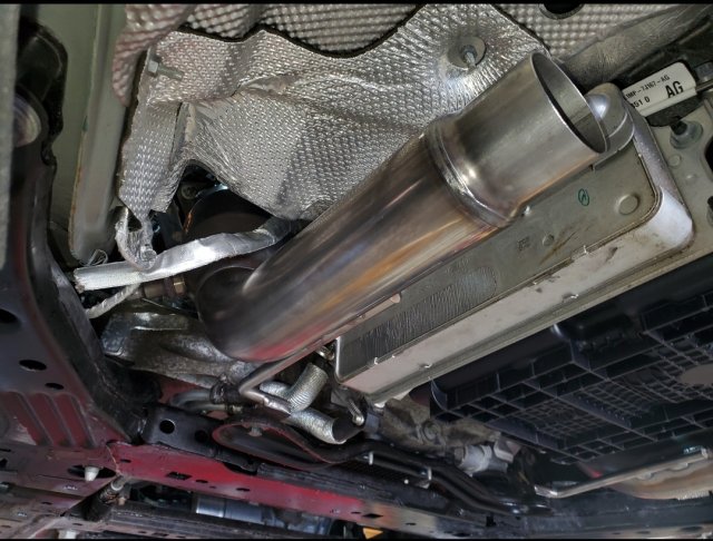

Added AFE intake, SPD catted downpipes and Xtreme-DI EVO HPFP.
