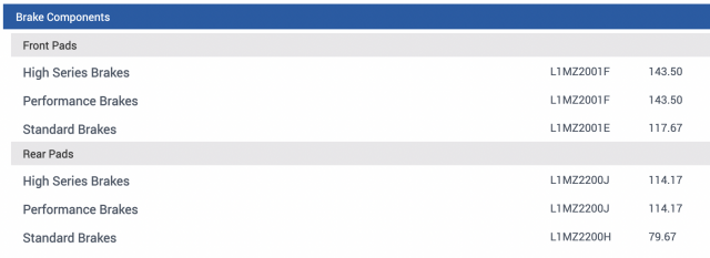

I'm having a really hard time finding the part number. I have the street pack but want to upgrade the pads to the track pads from the Track Pack.

So i didnt verify with my parts department yet.. but this is off of AllData and using the VIN from a 2022 ST with the high performance pack. Interesting that the high series brakes and the performance brakes are same part number.... so I'll need to dive further into it.. but this might be a start
