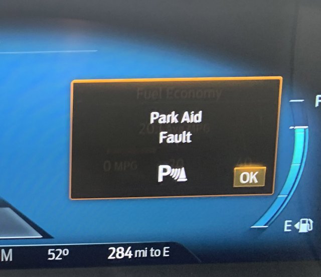

While creeping along in stop and go traffic yesterday this “PARK AID FAULT” message appeared with the OK button option. Of course shutting off the car and opening the drivers door resets everything. I haven’t seen it again. Anyone else encounter this?

Once in a blue moon, I will get any number of faults. Never any lasting problems though so unless you keep getting it, I wouldn't worry too much.

Just had this pop up and it still persists even after a restart. Any ideas? I have a feeling my battery may be the issue. I say that because my start stop hasn’t worked in awhile, which is fine by me. But I know electrical issues tend to creep up with battery issues. Sensors are clean and appear fine visually on inspection.

My ‘22 just started this nonsense over the weekend. None of the sensors are obstructed because we keep the vehicle nearly spotless. Could it be that we are washing the vehicle too much?
Yes, keeping it too clean also messes with the vehicle’s aerodynamics. :geek:

I had same error. Sensor took impact. Had to be replace. I could barely see gravel impact to painted sensor left front. Replaced and resolved. Painted sensor was more expensive.
