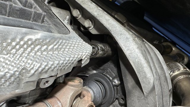

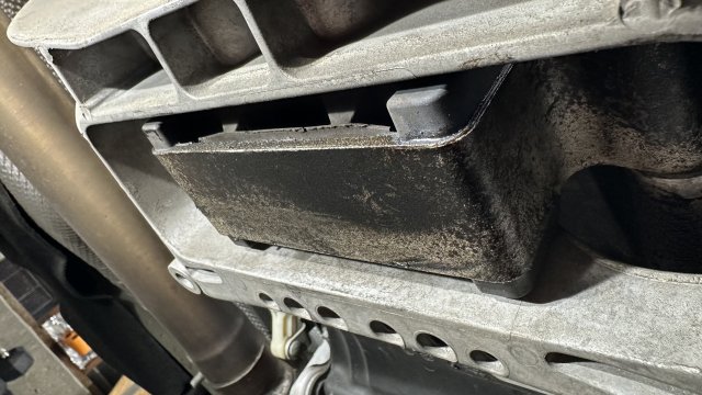

Hey everyone,
I was changing oil today and I noticed some oil splattered everywhere. Any ideas? Thank you in advance.

I cant tell from the pictures. My first guess is the transmission cooler. It's on the left side of the transmission.

Was this before you removed the filter and before you added oil. I thought I had a small leak and dealer brushed it off as it came from whoever changed the oil, but they didn't know that person was me. I am usually pretty careful not to get oil everywhere. I also had two 2017 Explorers and they both seemed to leak either engine or trans fluid.

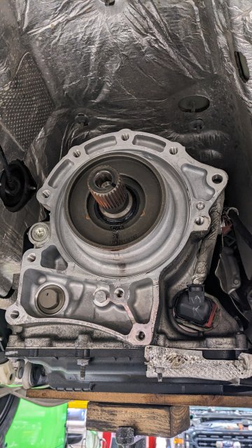

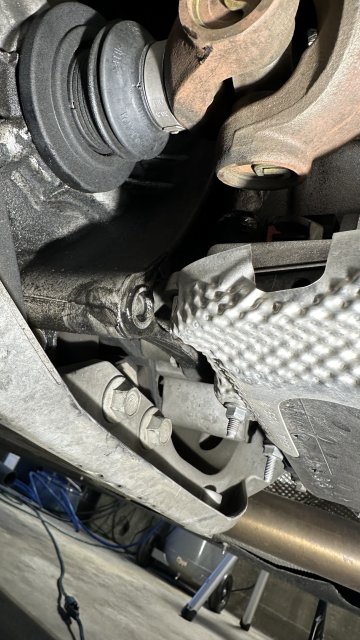

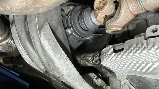

We just had ours in the shop for another oil leak, this time it was an output shaft seal in the transfer case.

This looks like it could be the issue. Yay!! Another leak
