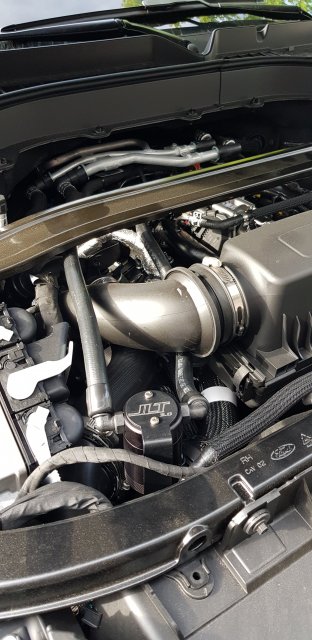

JLT is waiting on an ST to do a kit fitment. I am waiting on theirs. They are up in Virginia.
I ordered the JLT today! Said it would ship to me within 2-3 days.
It is a great kit, and VERY easy to install. First mod after I bought mine.

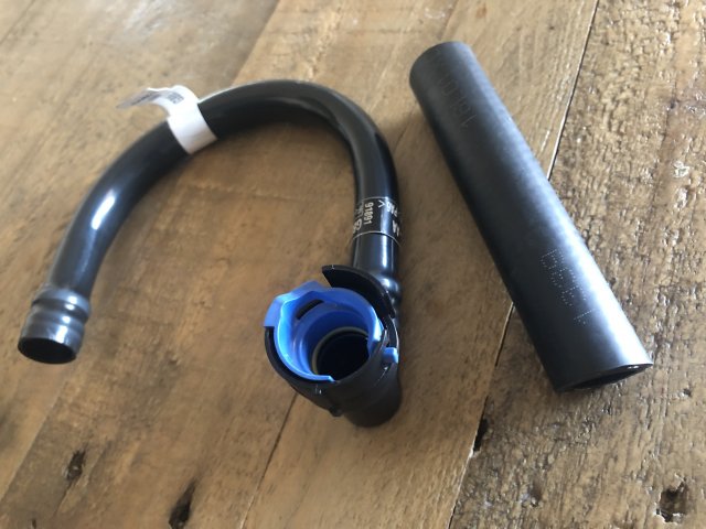

I just threw my UPR Catch Can in this weekend. I had everything but the clean side separator done and zip-tied in under 30 minutes. Then spent at least an hour, on two separate occasions, trying to get that orange fitting off. I tried using a pick, using a fuel line release tool, making my own tool out of a hose clamp (slimmer than the fuel line release, so that I could slide it in like a shim), and nothing would work with that tamper resistant fitting. I finally just pried it off and cut the plastic tube off. I cannibalized the slightly longer, curved tube I removed from the valve cover and intake, and used some rubber hose and clamps to secure a blue fitting in the orange one’s place.

Aha hahahahahahahaha so I wasn’t the only one!!!!!!!! I destroyed the orange clip. I ended up removing one the the blue clips and using it In place of the orange clip. I remember thinking what a butcher I was

Yep, me too. I’ve attempted getting that orange clip off twice with no luck. I’d like to know what prompted Ford to put that tamper proof connector on there in the first place. It’s just part of the PCV system so why not put it on all the connections then. Weird. I’ll get it off. I just don’t want broken plastic falling down into that valve cover.
