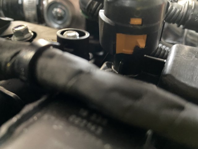

I need help on removing the fitting for the clean side where the oil separator goes. It’s a different fitting than UPR shows in their video. Here’s a pic. Any idea on how to remove this? Thanks in advance.
Anyone... Anyone?

I’m going to call my dealer, and UPR on Tuesday. I’ll update this post after.

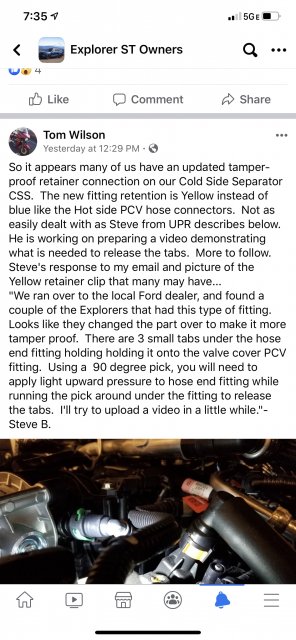

#20
Well... I guess I need to see which one mine has.
Just looked... same as pictures in the Facebook post above.
