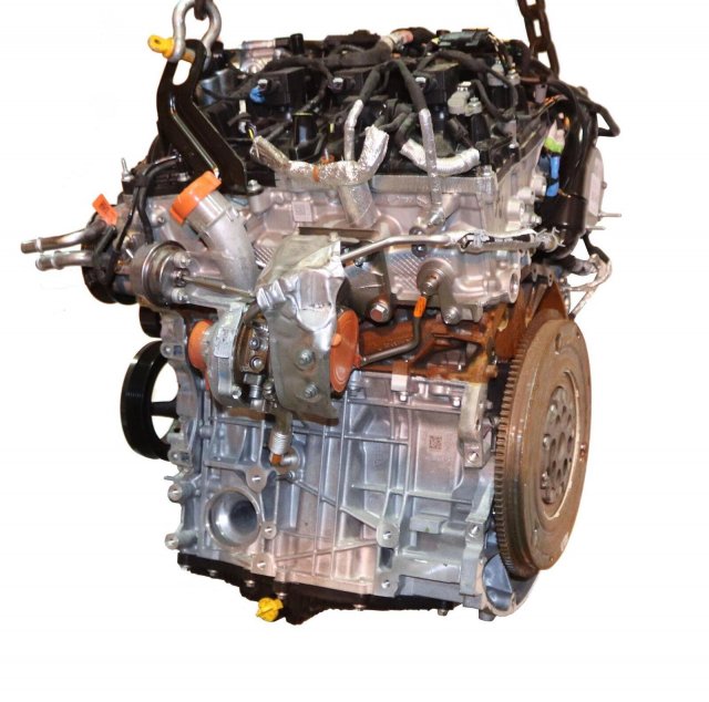

That said, the pans on these aren't deep at all. How far up the block skirt is the actual level? The picture below shows just how small the oil pan is, much of the oil is up into the skirt.

But look at the height of the centerline of the crankshaft. It's a long way from there to the bottom of the oil pan. @Cruising68 is right, adding a half quart more oil isn't going to affect the crankshaft once oil is displaced to the upper end when running.
