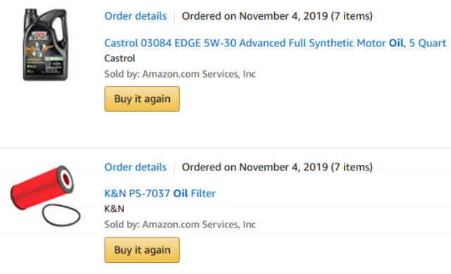

5.2 qts 5w-30 Full Syn. O rings came with K&N filter cartridge.

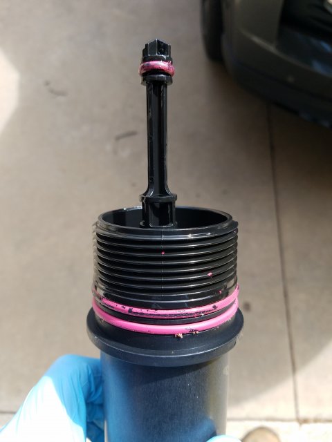

Also found out that the o-rings look like this when they've been used. Not sure what the pink stuff is that is coming off but the new Motorcraft filter had the same o-rings included.
