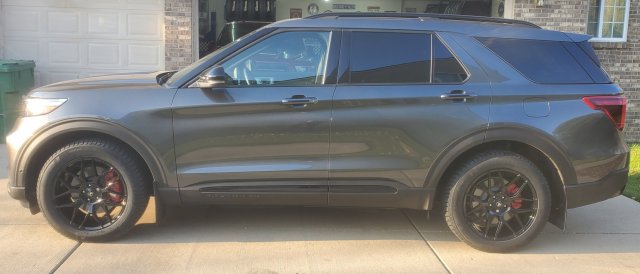

Hey all.... I have a stock w/ no mods 21 ST w/ street pack and looking for new wheel/winter tire combo to shelf the stock 21" rims and Pirelli 275/45 R21 for the winter
They were ok in Northern Ohio winter for 1st year, but thinking about something new.
A friend recommended Tire Rack.com & found their website as a great resource for picking the right combo
Any issues using the 20" Yokohama Iceguard 265/50 R20 w/ Platinum Atonement 20" x 8.5 Offset +40mm I may decide down the road to go to the 20" summer tires when the Pirelli's need to be replaced as the 21's are hard to find & expensive.
I am new to all this & would appreciate any feedback before I pull the trigger on the deal
