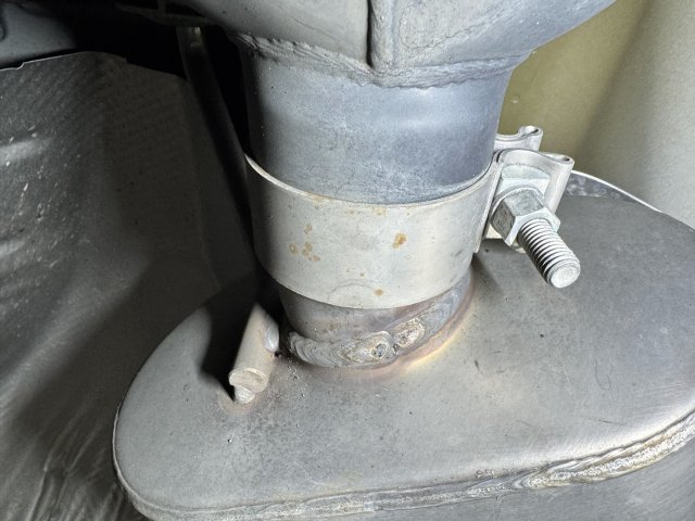

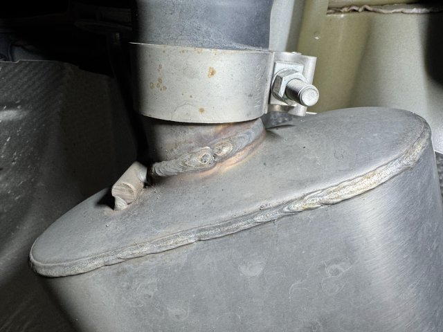

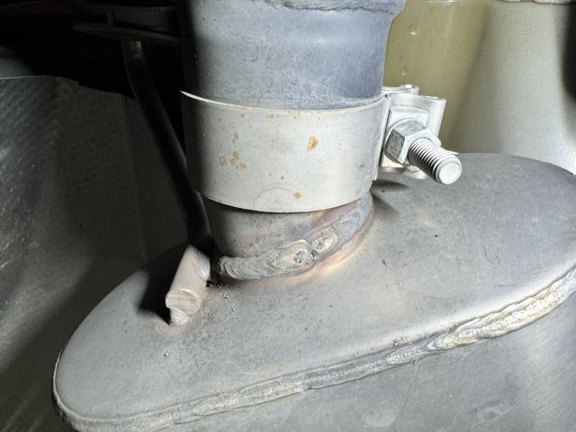

and the other thing I forgot to mention is "what's up with the exhaust tips and the clamping on the muffler - as in can't - get them tight unless you rent a Gorilla to tighten them and even then they are slightly loose" - :( good grief

I had the same issue with the tips, just could not get the supplied clamps tight enough so got some U-Bolt exhaust clamps that worked.

So on the tips being tight issue - the secret is to move the clamp all the way to the rear of the tips overlap and go a little over onto the muffler pipe about a 1/4 inch and tighten - wha-la tightens up nice and snug.
Ford Explorer ST 2021
I’ll give it a try if it gets rid of the larger uglier clamps I used

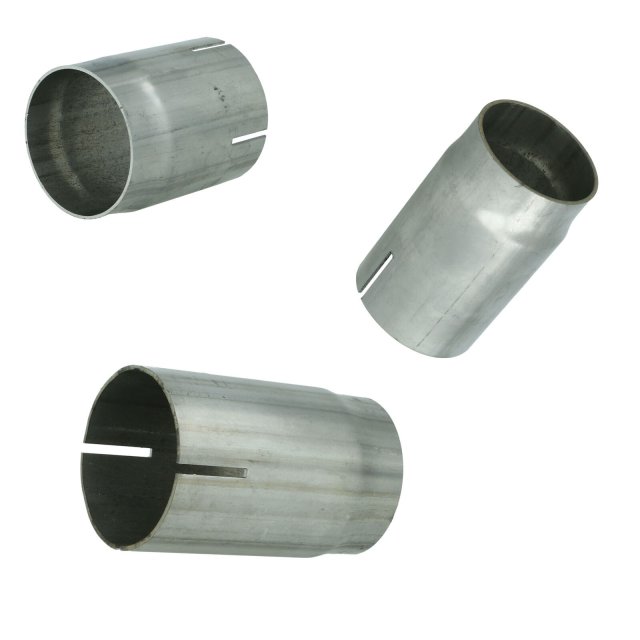

You can also cut 3-4 slits into the end of the tip to allow the metal to cinch down around the muffler exit better. That will 100% fix your issue. I use a cut-off wheel but a hacksaw will do the job as well.
A band clamp shouldn’t have to be anything but flush with the end it’s covering.
