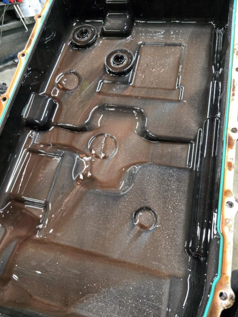

Today I just had my car towed to a specialized transmission rebuild shop. Luckily, we have a reputable one in town. They sent me a photo of the oil pan, and it’s full of metal debris, confirming that the transmission is heavily damaged. They explained that, in this case, it’s normal for the solenoids to throw those kinds of codes.
Ford had also reprogrammed my transmission yesterday, but it didn’t change anything—it still gave me the same error code on FordPass. Interestingly, FordPass hadn’t worked for at least six months, even after multiple battery resets and updates, but when the issue happened, FordPass suddenly started working again, which was surprising.
The shop gave me an estimate. It’s not cheap, but it’s reasonable. A rebuilt transmission costs around $3,500, including installation, while a brand-new one costs about $4,000 including installation. Do you think a rebuilt transmission might end up being better quality than the original one, considering the known issues with these transmissions? Would going with a rebuild be the better option in this case?

I would just go with a new transmission in this case.
A rebuild transmission will only be as good as the shop is, do you trust them? Have they done any 1080R60?
