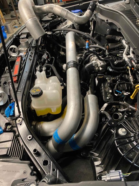

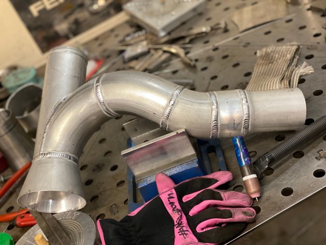

More mock up. I’m not an expert here but think I got this right. As of now he’s doing 4" intake into 2.75" into turbo inlets (merge pipe pic below) then 2.5" from turbo outlets into intercooler then 3" to throttle body.

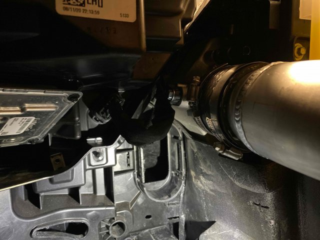

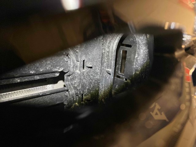

Is there any plan to try and use the existing inlet snorkel and having the filter as close to it as possible?
Looking through grill, inlet to snorkel...
View of snorkel inside...
Snorkel removed...
You can see the fitment problem. Retaining the snorkel would put the filter closer to hot engine bay air. We think it’s better to put the filter right in front of the opening getting the most fresh/cool air possible.

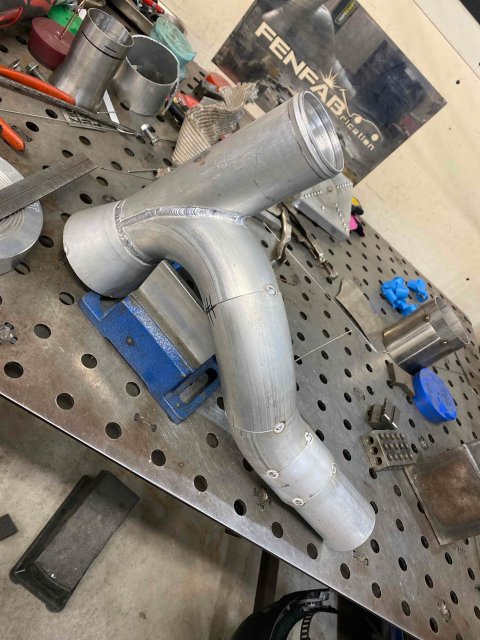

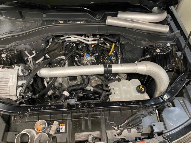

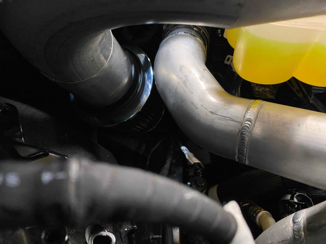

Mock up continues. Merging to the 4” intake heading down to the fresh air
30BF5F49-E06C-4064-9CAD-300D4D12356F.jpeg AEEDA679-546D-4B5C-914D-3C78561F239E.jpeg 9736EFEB-C535-4E86-938C-29822DE3EE41.jpeg 278B4940-7CAB-47C6-ADB0-5613E46AC200.jpeg

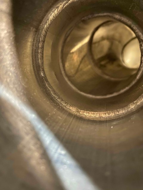

Thread Starter #31

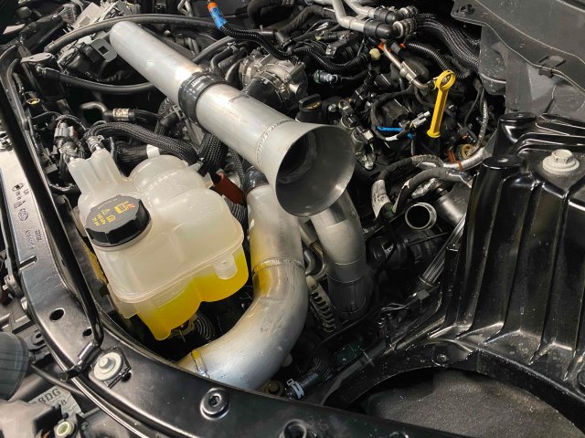

Coming along
4F2A1A99-D2A2-4DAC-A9A6-C93D050DDE35.jpeg A1987B00-5467-4451-84FB-F5E375D34C58.jpeg 397D9394-CB35-40D7-A07E-7A284FAFDAA0.jpeg 025EA238-B620-4338-BEBD-A65B46D98A11.jpeg
