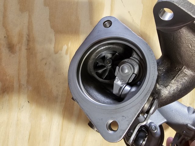

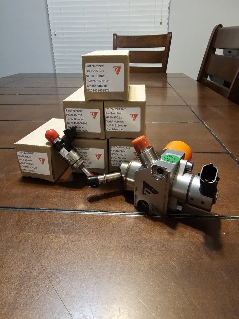

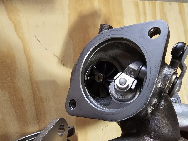

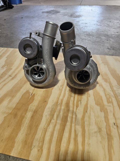

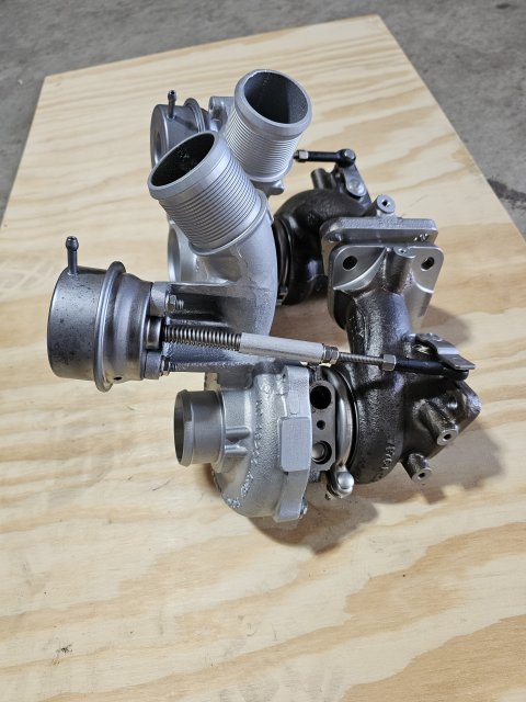

I dropped my ST off today to get the Stage 5 turbos and Stage 3 injectors installed. Once these are in, I think I'm "done" for a while. Well, until I break something anyways. LOL
View attachment 29227 View attachment 29228 View attachment 29229 View attachment 29230 View attachment 29231 View attachment 29232
Nice! You shouldn’t break anything if you don’t drive it hard all the time…. But what’s the fun in that :)

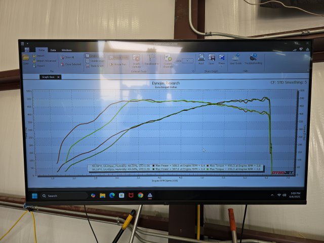

Well, the install went fine and after priming the fuel, she fired right up. Currently running 93 and getting logs for Goosetuned. After the 93 tune is finalized then moving on to E85. The ST already feels stronger than the E50 tune I had, but it might just be in my head, as I dont have any hard numbers just yet.

I made 508/496 on the 93 tune in 4th gear.
Probably making quite a bit less in reality though correct? 7th gear is 1:1 on the 10r60, so pretty sure 4th gear pulls inflate the torque numbers.

No, it wont make quite a bit less in 7th. The fuel and air requirements of the engine dont care what gear you are in.
No that’s not what he’s talking about, he’s talking about the gear ratio difference between 4th and 7th gear.

Any decent dyno shop will calibrate the dyno to match the engine rpm based on the gear used for the pull, making the gear selected irrelevant. I was told by my tuner to dyno in 4th, the shop wanted to do 3rd, but I insisted because I was getting logs as well. Having the dyno done in 4th will reduce stress, time under load and be safer all around than trying to dyno in 7th, per my tuner.
